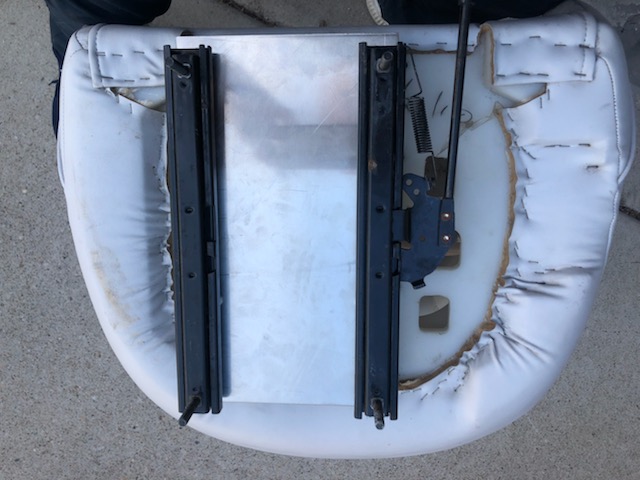

4. Remove the seat cushion (velcro attached) from the seat to gain access to the four 13mm nuts holding the sliding track to the seat.
5. Remove the four 13mm nuts holding the sliding track to the seat and remove the track from the seat. (save the nylon spacers!  You will use these later.)

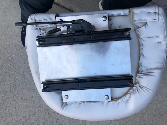

6. Clamp one aluminum plate on the bottom of the seat where the seat track bolts to the seat.  Mark the bolt holes on the aluminum plate with a permanent marker where the seat track bolts to the seat. Remove the plate from the seat.  You will drill four 3/8" holes; one on each mark.
7. Center the swivel on the aluminum plate you just marked and mark the position of the swivel on the plate with four marks.  One each for a 1/4" hole.
8. Drill four holes slightly larger than 5/16" where the plate will mount to the seat; one hole at each mark.  The hole needs to be big enough to get the carriage bolt to "stick" in the round hole.
9. Drill four 1/4" holes where the swivel will mount to the aluminum plate.
10. Lay the drilled plate on top of the un-drilled plate and mark the same holes on the un-drilled plate.
11. Drill the same holes in the second plate to match the first plate.

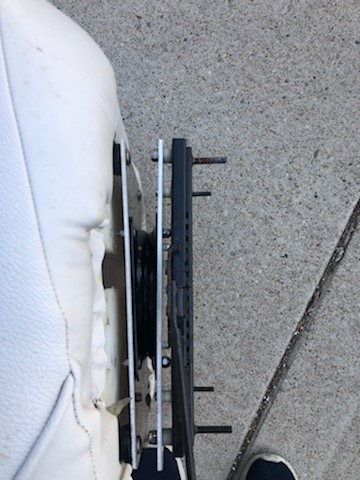

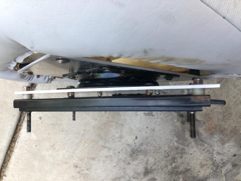

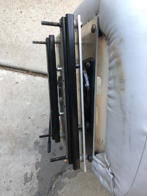

12. With the 1/4" carriage bolts, mount the swivel to the first aluminum plate with the thick part of the swivel to the rear of the seat.  Only one side of the swivel is thick (or tilted).  This should be the plate that will bolt to the seat.
13. With the remaining 1/4" carriage bolts, mount the swivel to the second aluminum plate.  Cut off or grind off the excess bolt material that extends past the lock nut.  Nuts should all be on the plate side; not on the swivel side.
14. Mount the plate to the seat using the original seat mounting bolts and rubber grommets/bumpers.  Grommets/bumpers go in between the plate and the seat bottom.
14. Mount the sliding track to the plate with the 5/16" carriage bolts that are 1 1/4" with the nylon spacers in between the track and the plate (see photo).  Bolts should point toward the swivel. Remember, the sliding track release goes on the left side of the seat and points forward.
15. Cut off the excess bolt material that extends past the lock nut with a hack saw or saws-all.
