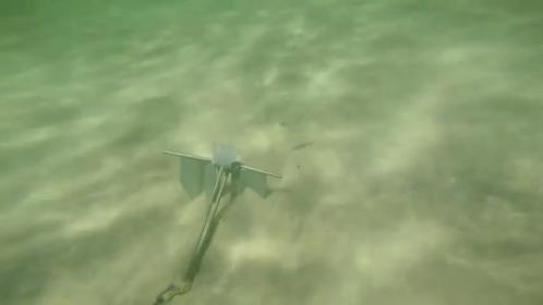

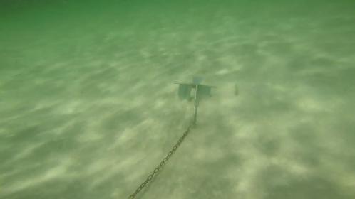

Below are some pics pics from a trip to the gulf in the previous boat. It shows what I’m talking about with what we experienced using the danforth anchor. Notice it favored one side of the anchor than the other which causes the flukes to not fully or equally set. Even after setting it equally with my feet driving both flukes down into the sand it would always eventually roll. This is with proper scope / rode length. It worked well in I’d say 75% of the time under varying conditions for nearly 3 years. It wasn’t a bad anchor by any means but it wasn’t great either for us. The box anchor I’d say has worked 95% of the time in just one season of use and on larger lakes. I only used the box with the previous boat as a backup or secondary when the danforth couldn’t hold alone. So far so good using it by itself on a larger and heavier boat. I’m also glad I’m not dealing with an rusty, nasty anchor chain any longer that can stain or ding the gel as you retrieve. With the box you drop it and that’s it. Eazy peazy.
