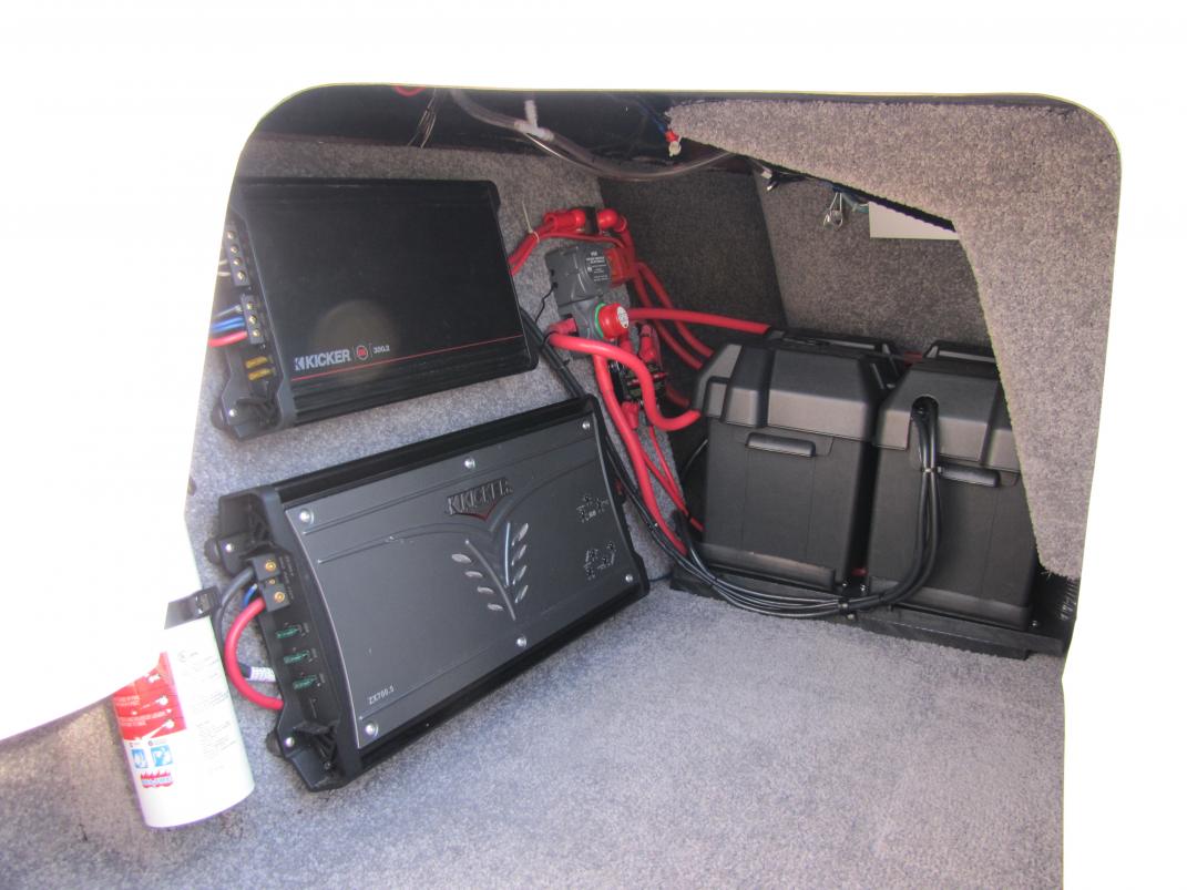

Here’s mine...https://flic.kr/p/TtNsNo
there are a lot of guys who know stereo systems/set ups a lot better than me but i would not want any of my amps or stereo equipment on the floor of the boat. Everything i have seen is always mounted on the side just in case you take water over the bow and get water in the boat.

oh, didn't notice they were above the floor. That is definitely better than on the floor. What I have seen is most put them on the side of the boat and then that also frees up more space on the floor for storage.

I am with the others in that I would not ever mount amps flat even above the floor. too much temptation to toss a wet towel or lifejacket in there. would also recommend that batteries are put in battery boxes. keeps something metal from arcing across the terminals and cleans up the storage space.
