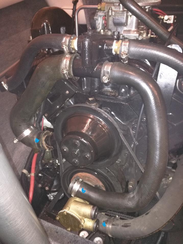

4 - Disconnected both hoses to fresh water pump and hose to lower thermostat housing and drained. Pictured here in Blue.

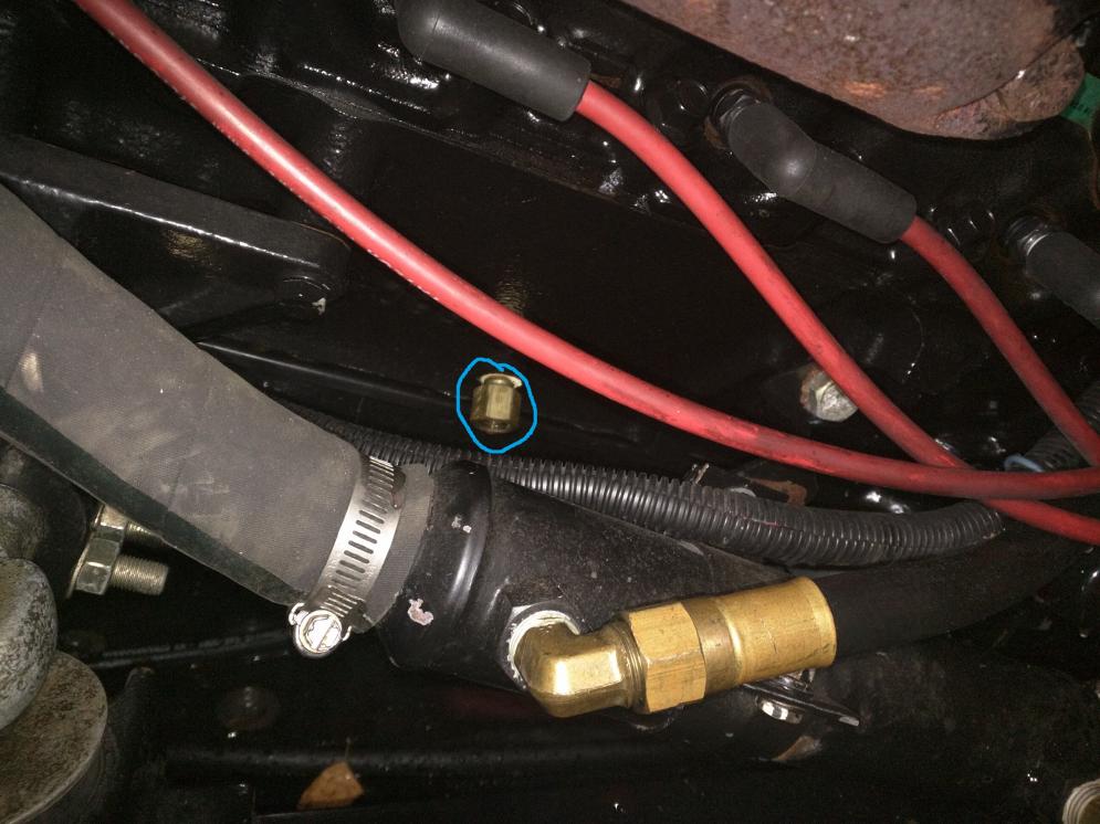

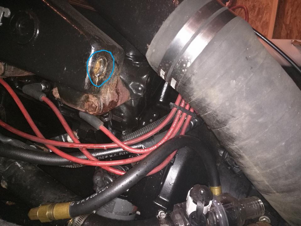

5 - Removed 4 drain plugs, block left/right and Exhaust Manifold left/right.

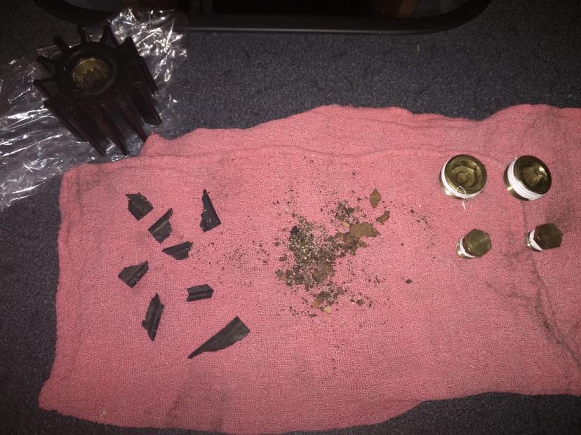

The impeller I took out was intact and appears to be new but when I drained the exhaust manifold ports, rust and chunks of old impeller came out (see picture). Does their presence in the exhaust mean I should check elsewhere (thermostat housing) for more chunks?

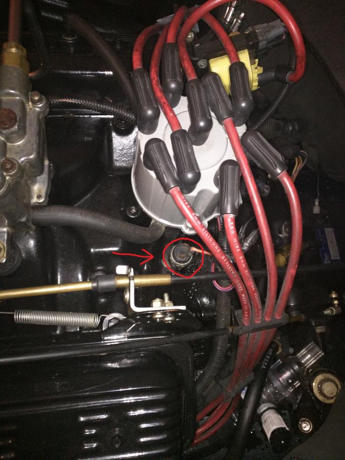

Lastly, help me identify this part. Indicated by the red arrow and circle. It looks like its been removed in the past with a pair of channel lock pliers. The collar of it is sorta chewed up and stripped of black paint.
Attachment 26428
