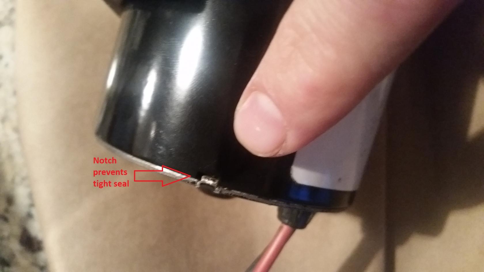

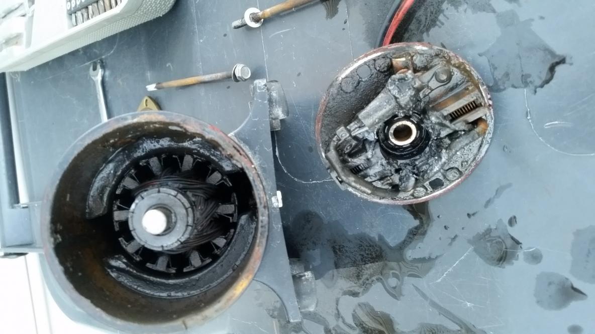

Water dripping from transom mounted cup holder onto the ballast pump motor can breach the motor casing on pumps mounted sideways. This is possible because the pumps have notch gaps in them and are not waterproof.

a. Dismantle and clean ballast pump with electrical cleaner and electric grease.

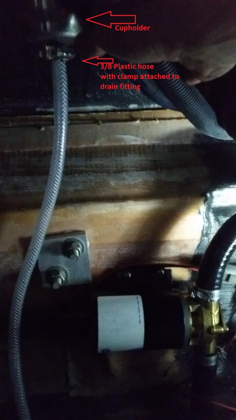

b. Install drain hose to cup holder draincock which will route all water directly to bilge area.

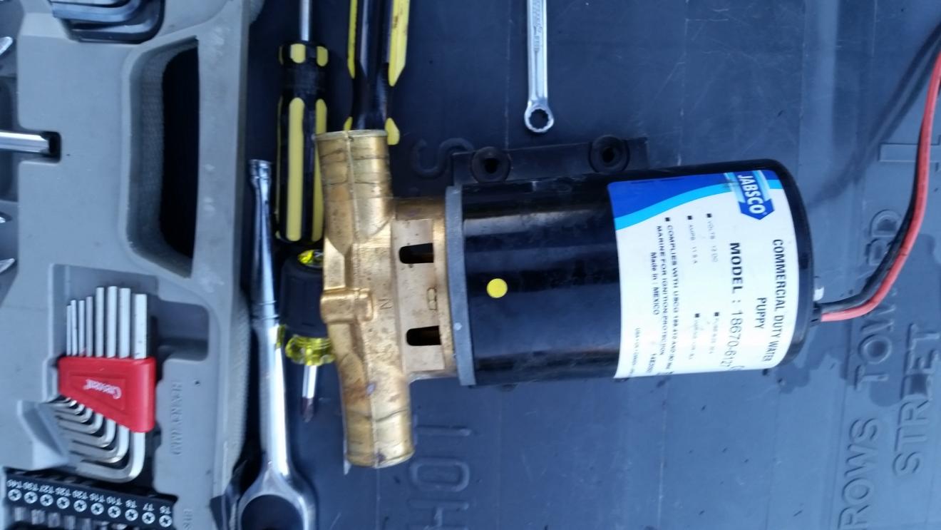

* Remove ballast pump from boat
* Remove cover on the side where the electrical wires are (opposite the pump side)
* Clean with electrical cleaner and brush
* Apply electrical grease
* Also Inspect impeller and lubricate with marine grease
* Reinstall pump
* Cupholder repair:
o Unscrew fitting on bottom of cupholder
o Install 3/8 clear plastic hose using a hose clamp. Hose should be long enough to route water directly to bilge area.
