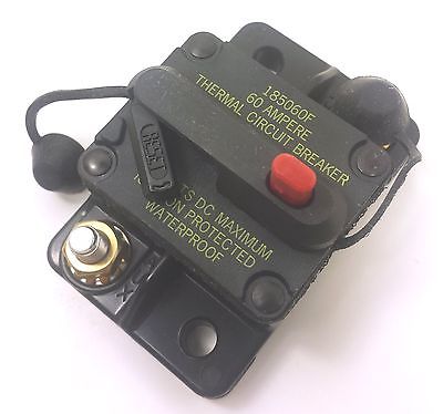

The 60 amp breaker that the ballast is routed through sometimes pops. :confused:

Attached is a picture of what the breaker looks like.
Attachment 24529

No need for math, each pump draws 20+ amps on startup, 3 pumps will trip it..
Solving the ballast breaker switch problem
You will need a meter that measures inrush current. Basically the current required to start the pumps. It will be higher than the 12amp continuous current.

I don't think all three well pull 20 each. I've never tripped mine and I fill drain all three all the time.
Same here. Never tripped this breaker.
Re: Solving the ballast breaker switch problem
My reversible pumps will easily blow 20amp fuse, the impellor sometimes sticks on startup to pop them. I noticed during a recent install wake makers is using 30amp fuses in thier kits now.
I used to pop that breaker often when my pumps were new or kicked 4 pumps on at the same time. Now I just make sure to press each button individually, instead of slapping them all on the same time.
Or when you're done for day after draining, flip the pumps to fill for a second. This allows the pump to start easier the next time out.
