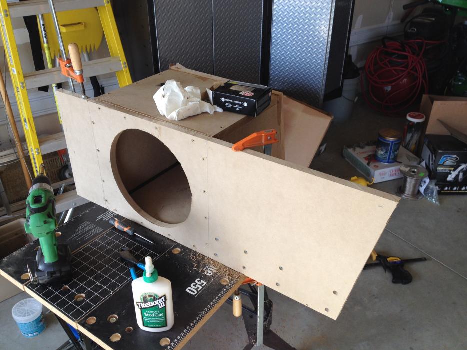

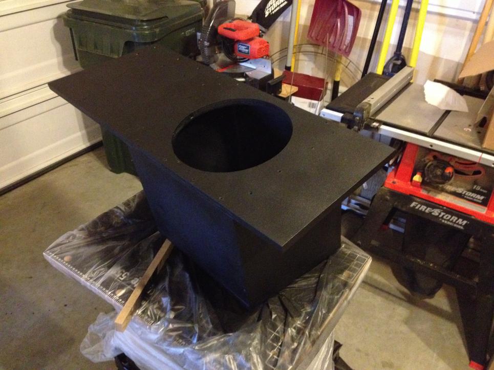

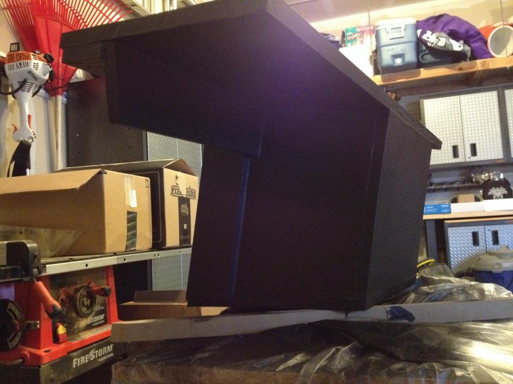

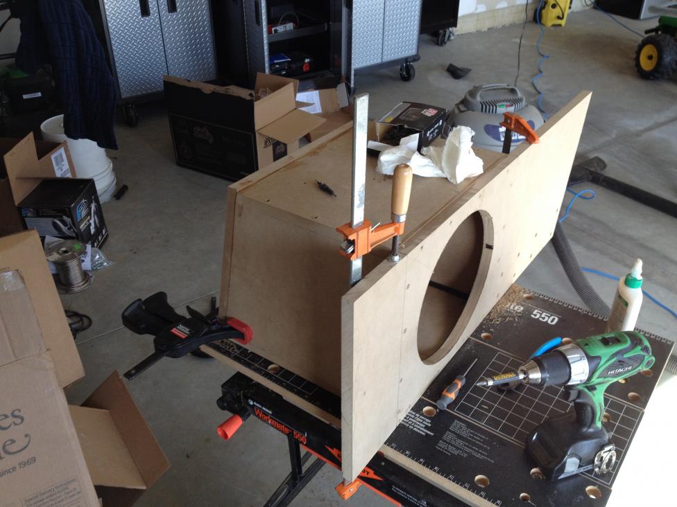

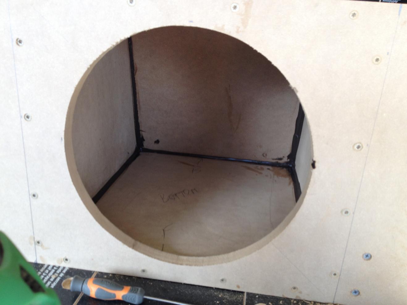

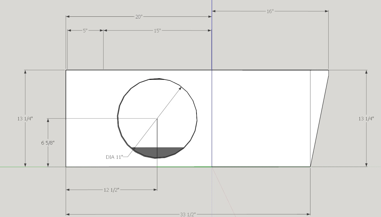

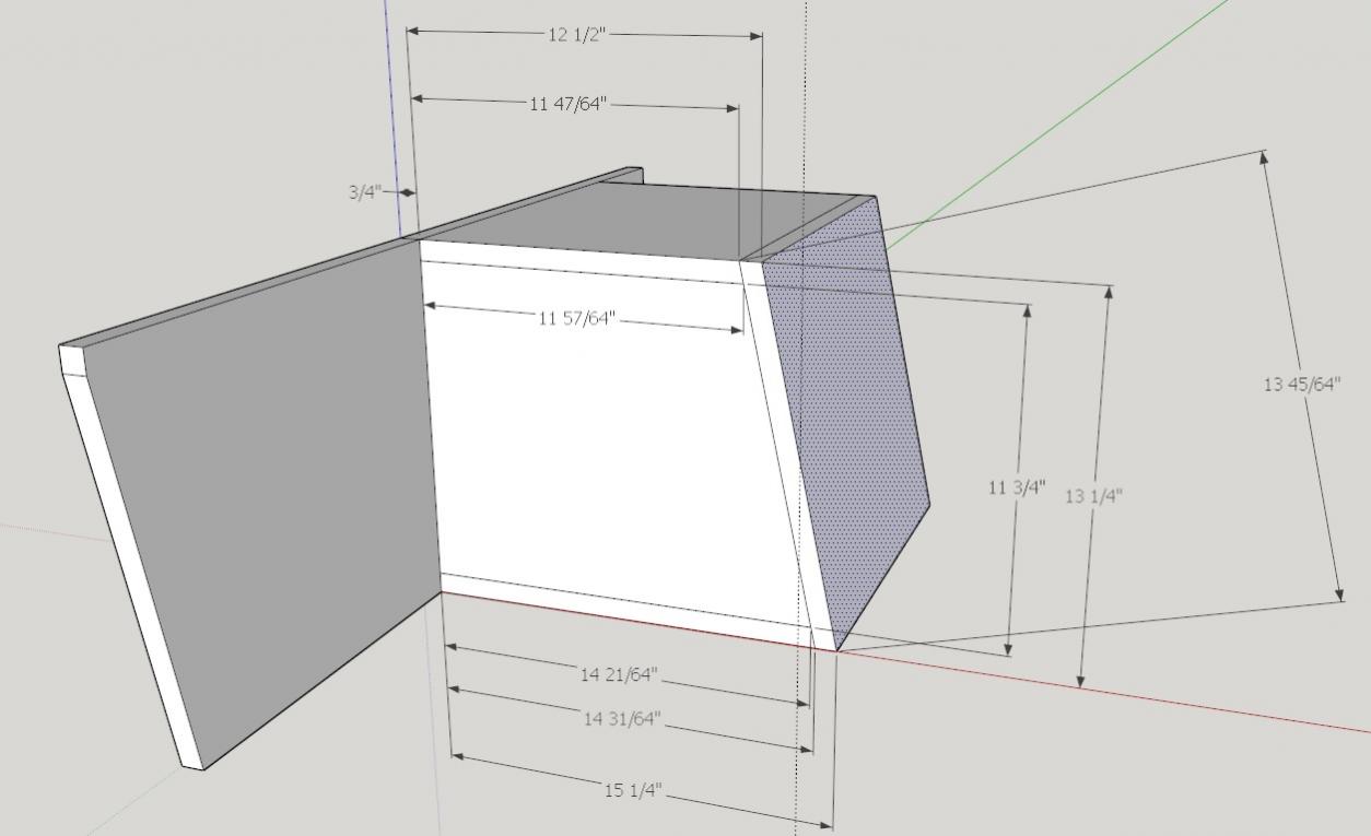

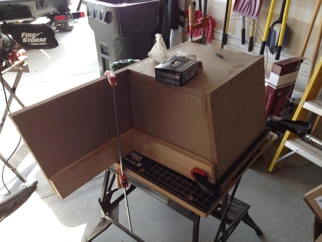

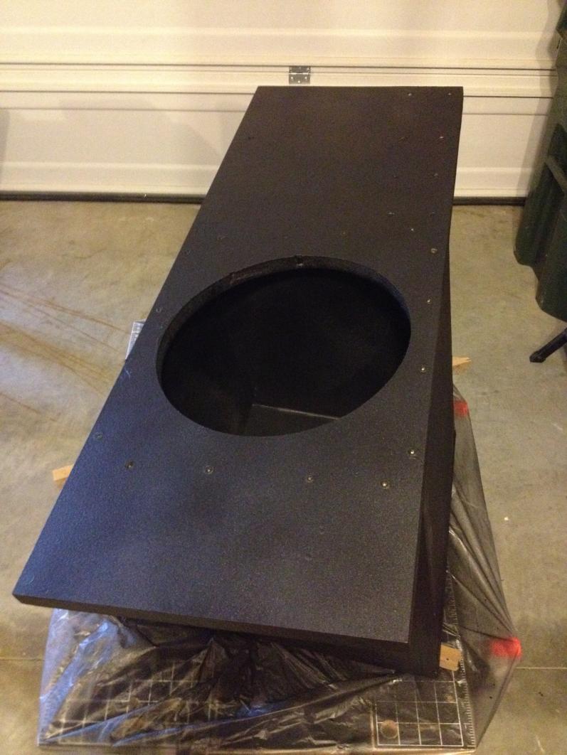

Here is my progress on the custom box, this will allow me to maintain my stock "footrest" and doesn't interfere with any of the other stock equipment. This is a sealed 1.2 cu ft enclosure.

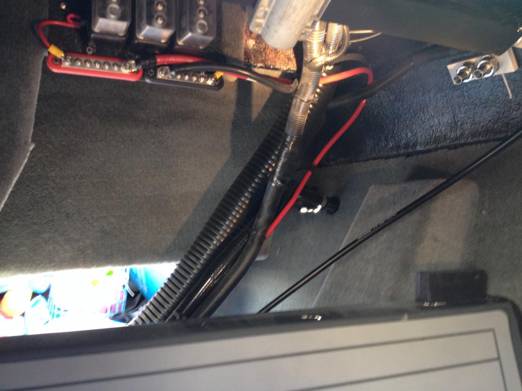

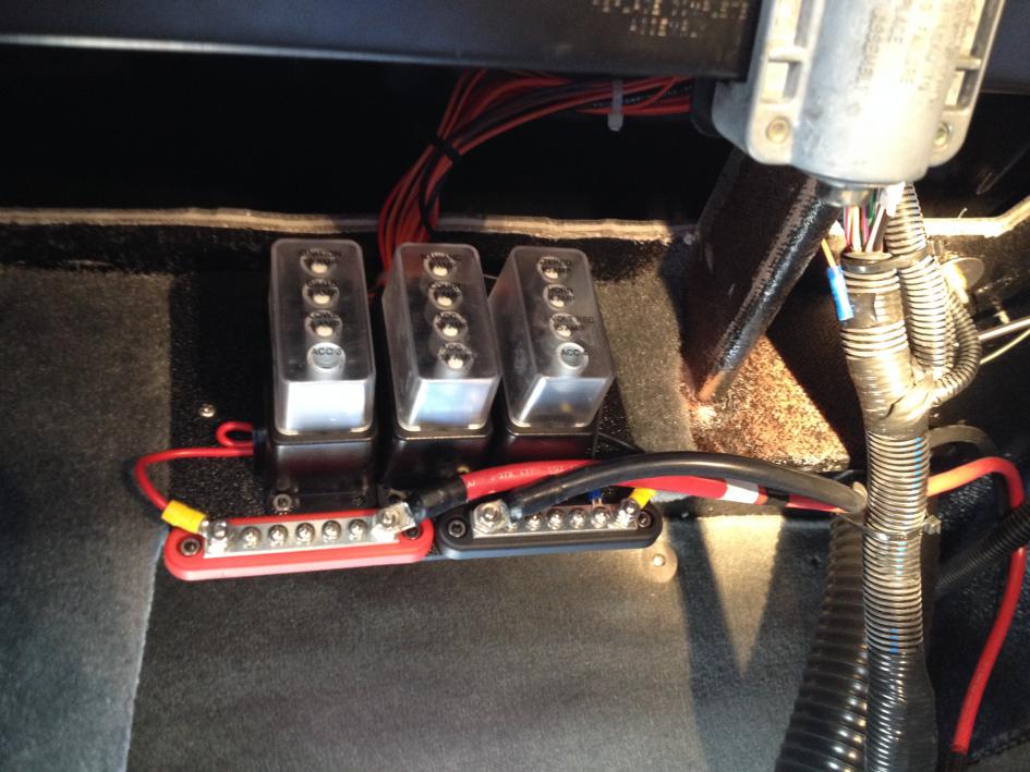

Space behind fascia, had to relocate the electrical stuff (2 screws and a little re-routing):
Attachment 19661Attachment 19662
Some Google Sketchup Planning:
Attachment 19659Attachment 19660
