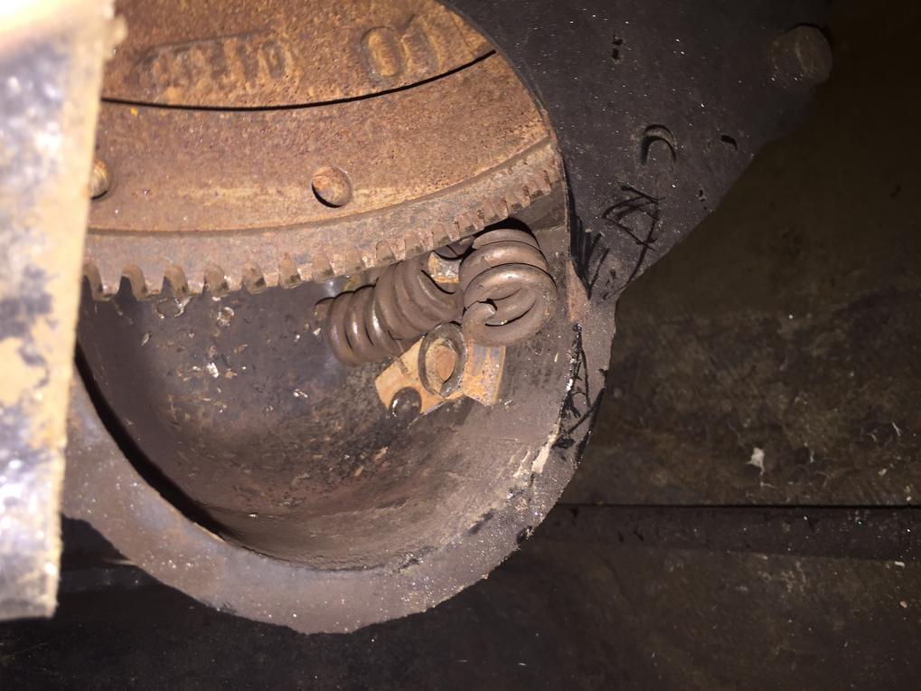

Attachment 22146

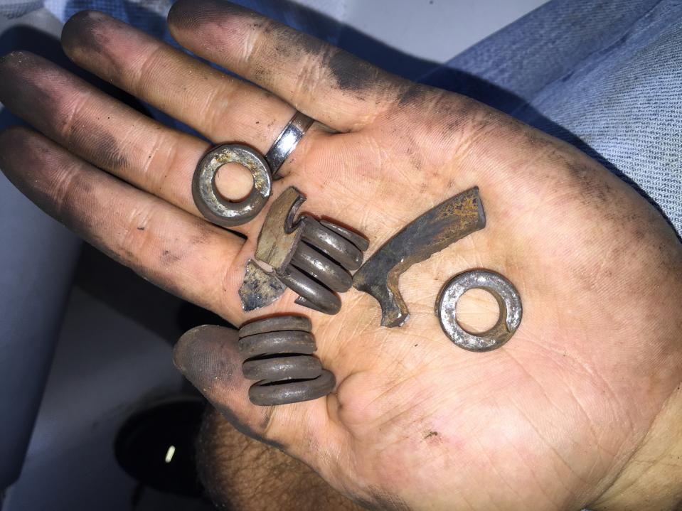

A pile of broken flex plate springs. So yes there is the smoking gun, I was lucky as there are some other posts out there where the broken springs had shot through the bell housing. My boat was still driving perfectly fine other than the ticking noise but probably wasn't far away from all of the springs failing.

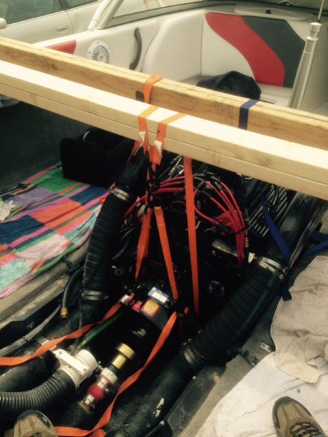

Step 5. Now it's time to support the engine. I took the hook on the front of the left bank cylinder head and put it at the rear so I had two hooks equally spaced. I'll probably take a beating for my hoist but it worked just fine. I also put a couple pieces of wood under the engine as secondary supports. The transmission was supported in the same way, it's not that heavy and this is just an interim step while you loosen the bolts.

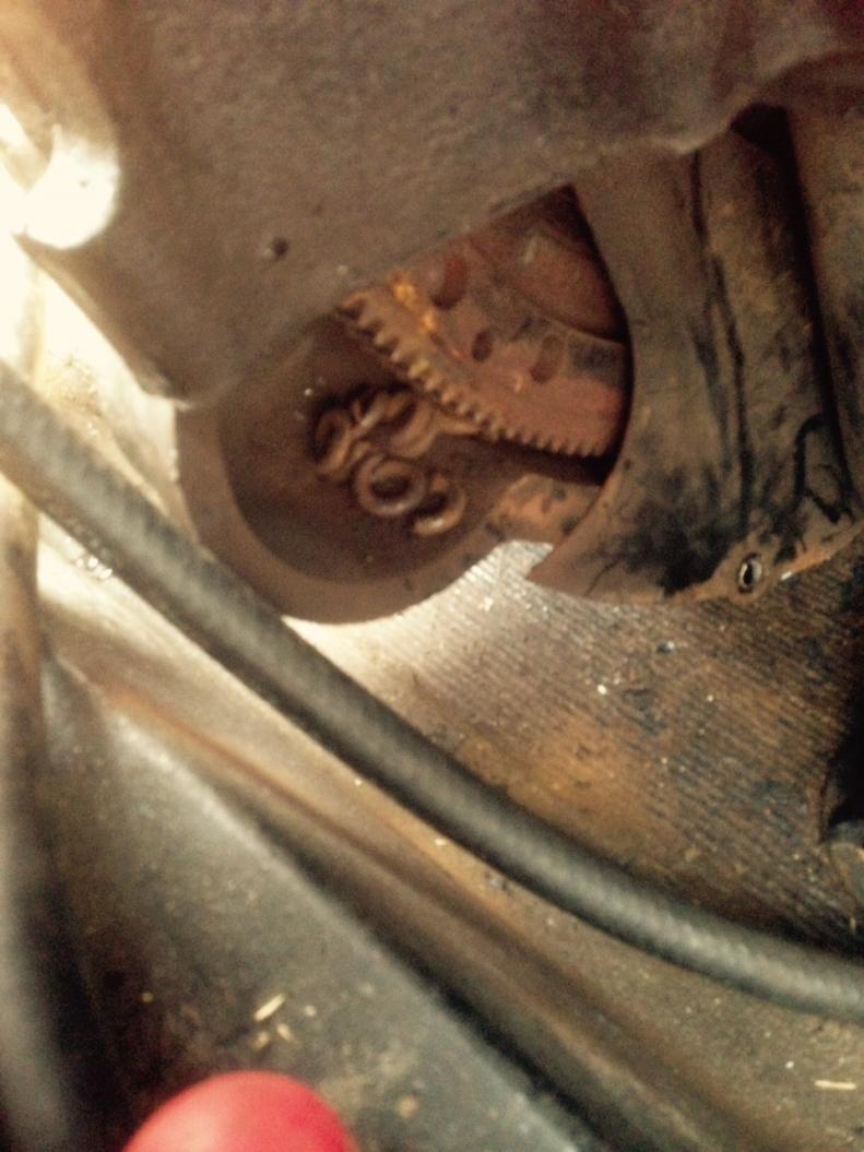

Step 6. Remove the flywheel shield bolts. These are a bit tricky (even to find). You need to be behind the drivers seat and looking towards the back of the boat at the flywheel , there are two bolts holding the shield on, on either side of the engine. I used a flex and some long extensions to loosen these. One of these locations is shown in the empty bolt hole next to the starter hole in picture #1.

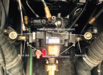

Step 7. Ok now with the engine and transmission supported it's time to remove the vertical motor mount bolts, you will also want to loosen the horizontal wedge bolts (which control the side to side position of the engine/transmission. Before loosening anything put paint dots on the vertical bolt threads right above the transmission crossbar and on the crossbar where the wedge bolt is, this is just to get you close when you put it back together, you will still need to do an alignment. After you mark the current postion, loosen the wedge bolts and remove the vertical mount bolts . For the vertical mount bolts you will need to loosen the locking nut above the cross bar and then get a 15/16 box end on the nut on the very bottom. You'll need to move the locking nut down as you loosen the mount bolt. I read some other posts for older boats where they removed the mount right off the transmission, there is not enough room on the 05's.

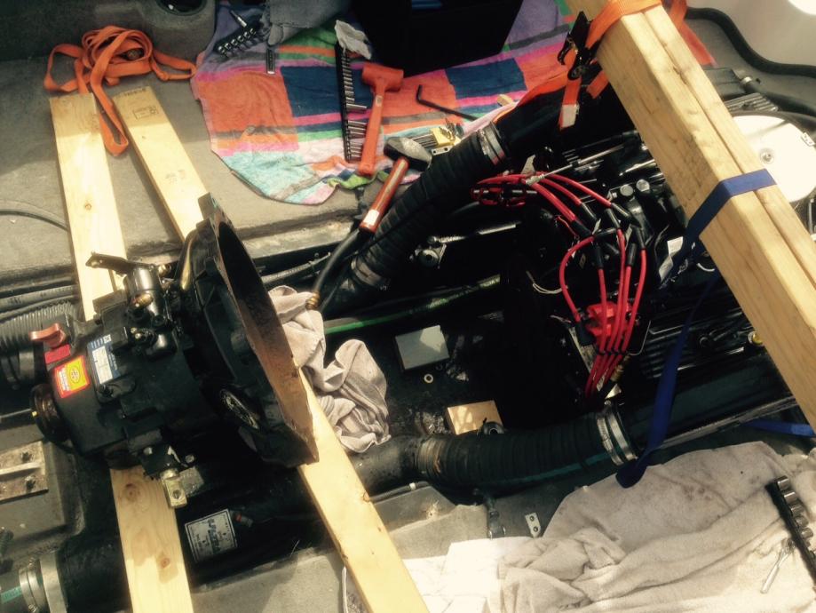

Step 8. Remove the flywheel housing bolts. You may want to leave one hand tight until you're ready to remove the transmission but the transmission is doweled as well so it's not going to just slide down, I had to rock it pretty good and slip a pry bar in to separate it from the engine. Once it's loose have a buddy help you lift it onto some 2x4 behind the engine.

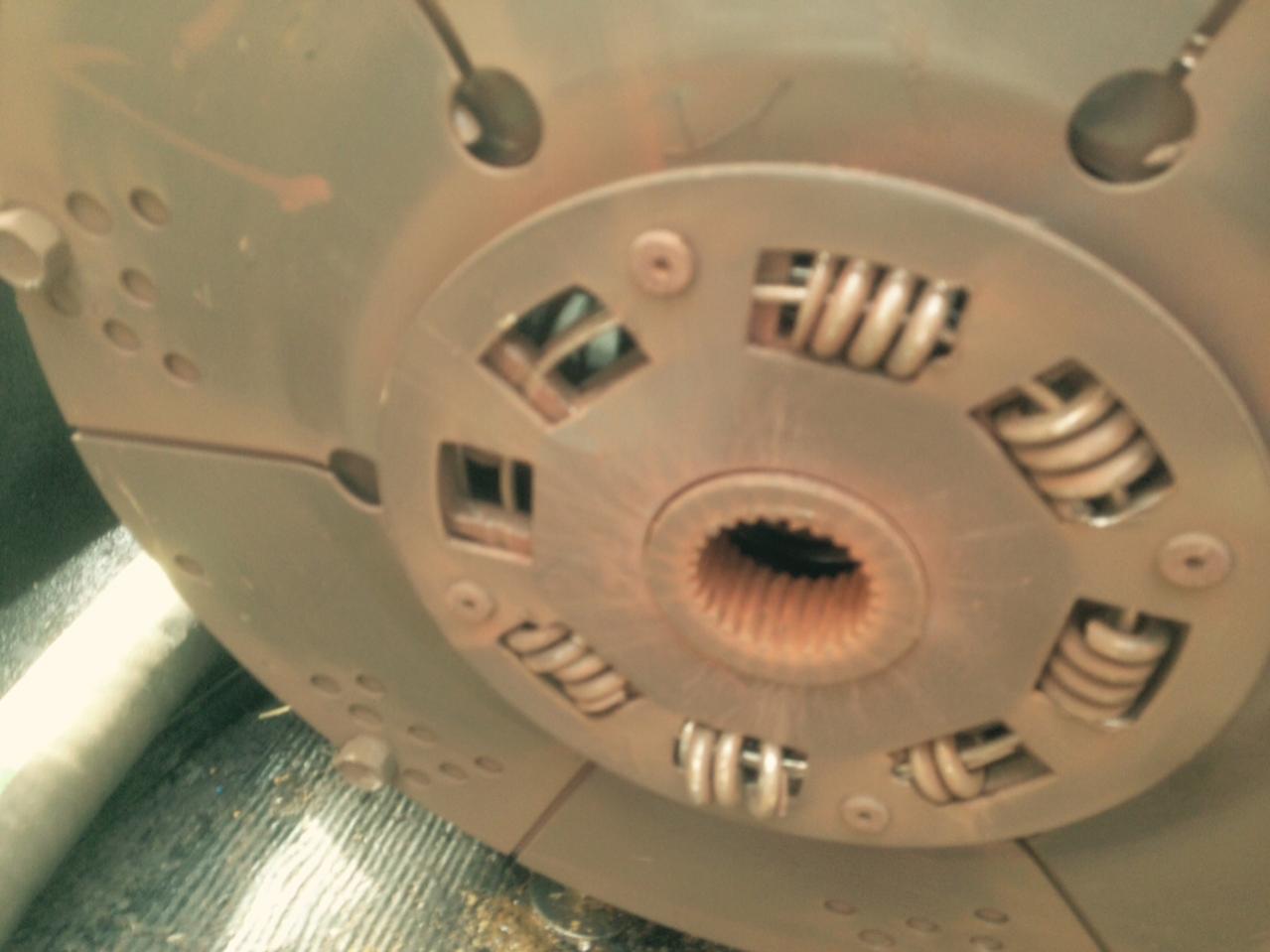

Step 9. Remove old flex plate and install the new plate, torque to 35 ft lbs or whatever your clymer manual states for your boat.
